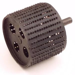

Here are some tips just about ready to go, just need to flatten the bottom and even the feathered ends a bit:
I use a rotary drum rasp for the taper.
