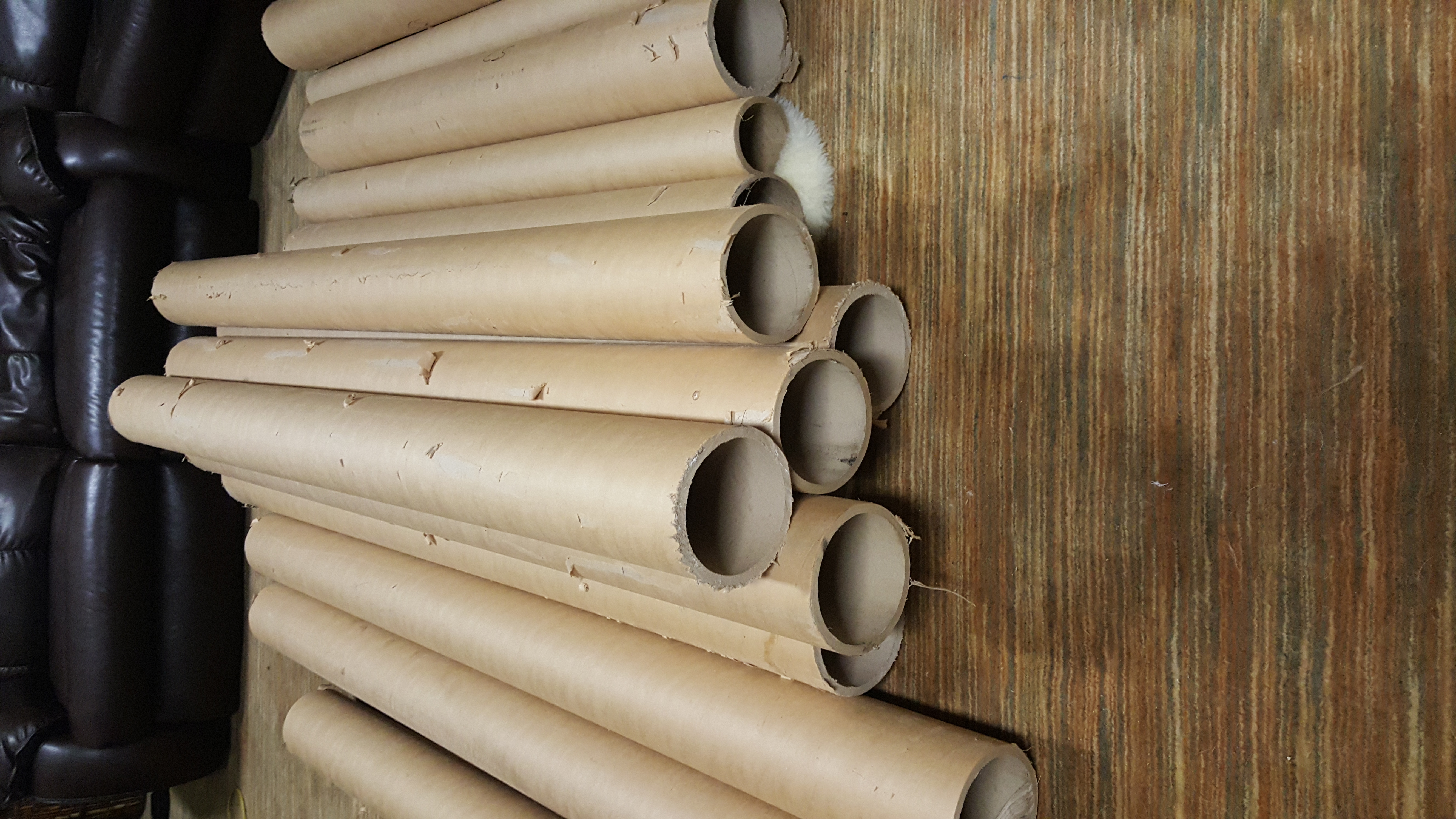

Terry Green
My HEAVY GUAGE Bow Shipping TUBES...Never had an issue with destruction.  If you buy a bow from me, you are going to get the best I can offer.
