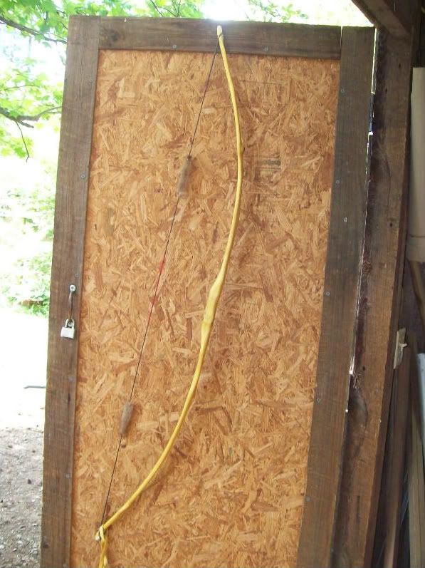

I'm looking for mid 50s at 27".
Here it is after 10 scrapes at the marked locations.
Take a kid hunting!
John Scifres
Better at the handle but midlimb on the right (upper) needs a touch.
Here it is after 10 scrapes there.  Getting closer but the left midlimb needs a hair.
That's pretty good for on the tree.  Drawing 55# at 26".  After shooting her in and finish I should hit weight.

Here she is drawn by hand.  I think she bends too much at the handle on the lower limb.  Maybe not though.  Whaddya think?
Here she is straight off the string.  Holding pretty straight.

She looking pretty good to me John. I do see under the handle a bit more bend. It doesn't show up on the tree.   What's the length?  60"?
Make the most of all that comes and the least of all that goes!
John Scifres
She's 63" total, 61-1/2" NTN.  I think I'm going to shoot her a little bit tonight and then see how she feels.
