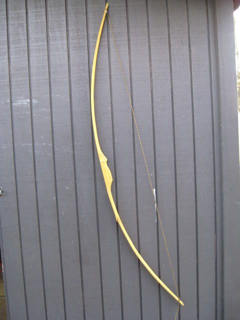

Maxximusgrind
My first good hunting bow (that I made)was lumberyard ash.I think I got lucky on how it worked out.It pulled 63@28".It stacked at full draw,but I left it at that because I didnt want to loose any weight.and didnt back it because I wanted to see how long it would hold.After about 3 and a half years it developed a crack from the stacking,But it was a great time while it lasted.
